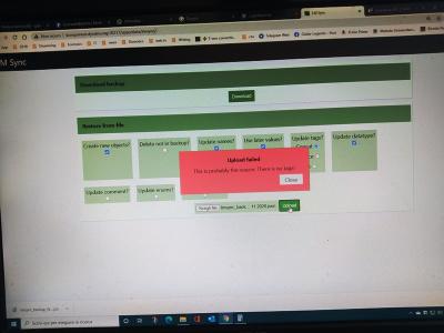

Hi, is LM Sync actually working?
Everytime I try to upload a file I get the attached message...

Everytime I try to upload a file I get the attached message... Peppe
11.11.2020, 16:57
There was a change in backup structure and now it requires "tags" key instead of "objectTags" in json. I've added backward compatibility function but it will be available when openrb will release updated version (I've sent it today to Edgars).
