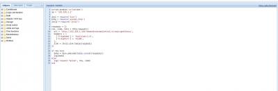

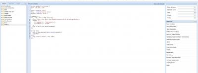

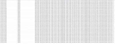

I endered the script on the Resident Script tab (I don't know if I have done well or I had to choose another Script tab to create this Script) by creating a new Script and named it as YAMAHA. Also I entered the IP of the Yamaha Speaker and  I checked the logs. It runs the script and now how I am going to visualize it and make it usable and make the functions like controlling volume , changing tracks or web radios or even changing the source from LM application something like SONOS app?
Thank you in advance for your help
Also I forgot to mentioned that the IP at line 2 I changed it to 192.168.1.169 which is the IP address of the Yamaha Musicast Speaker

First of all don't run this script with 0 sleep time, it will consume all CPU resources of the system. To write data to objects use grp.checkwrite(address, value). Make sure that you have created objects beforehand and that they have matching datatypes for the data that will be stored there (string, boolean, number).
if res then   data = json.pdecode(table.concat(respbody))   if type(data) == 'table' then     grp.checkwrite('1/1/1', data.input)     grp.checkwrite('1/1/2', data.mute)   end else   log('request failed', res, code) end
For control you will need to create an event script for each action and send HTTP requests to the speakers. You should use different objects for control and status otherwise it's possible to make an infinite loop which will also overload the system.
