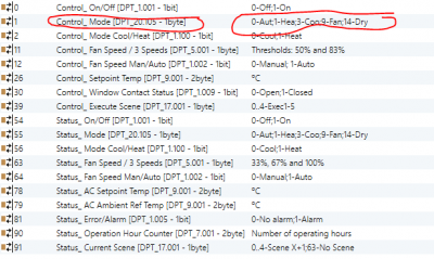

hi,
on wiser 4knx ios app, how you deal with changeover on dpt20 group adress ? I only found for 1 bit changeover object.
Only solution script ?
regards
FRANCE SMARTHOME & SMARTBUILDING INTEGRATION
SE ECO EXPERT
Posts: 5344
Threads: 29
239
Script

(18.06.2024, 06:32)Daniel Wrote: Script
ok thanks
