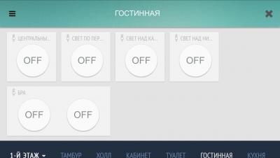

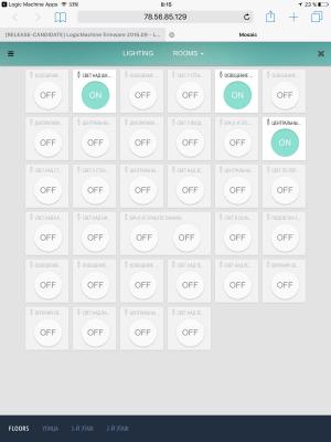

Noticed some problems in Mosaic:
1. Adding widget - widget jumping to screen somewhere (right side of screen, to the bot side and etc.)
2. iPad horizontal orientation - widgets big, iPad vertical orientation - widgets too small, text not visible
3. Few times noticed - no widget at all, screen empty, just written "Main screen"
4. iPad horizontal orientation - left side vertical toolbar always on screen and sometimes no reacts (pressing by finger), iPad vertical orientation - left side vertical toolbar hides/unhide correctly, reaction is good.
Have you tried updating the Mosaic app? The pre-installed version that comes with the firmware is older than the latest release.
Yes, Mosaic 2.0 was updated. To be sure all Mosaic apps was uninstalled and installed again. Tests was repeated.
Text cutting, size of widgets
See attached images, illustrating text cutting. You see iPhone and iPad screens.
iPad screen (vertical orientation) - very small widgets, text cutting.
iPad screen (horizontal orientation) - everything is ok, widgets are big, no problem with text cutting.
Left toolbar
iPad vertical orientation - left toolbar automatically unhides/hides correctly. Controls are ok.
iPad horizontal orientation - left toolbar always present on screen. Sometimes hangs - no reaction when you touching by finger.

(05.10.2016, 10:22)GenaV Wrote: Yes, Mosaic 2.0 was updated. To be sure all Mosaic apps was uninstalled and installed again. Tests was repeated.
Mosaic has just been updated, which should bugs you've mentioned. As for visual layout devs are saying that this is intended. Maybe a custom theme can be created which has different widget/text sizes.
