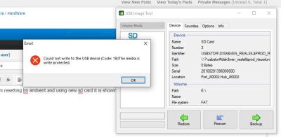

hello sir I tried it but it is showing this error

hello sir i am resetting lm ambient and using new sd card it is showing this error

Are you using SD to micro SD adapter? If so you need to flip the switch on the side to disable write protection.
