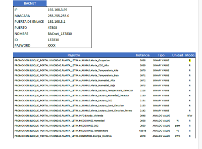

Good morning,
My client is requesting a BACnet IP mapping with a series of characteristics that I don't see in the Logic Machine configurations. They need a column with units and data type.
I'm not sure if this configuration exists to be included in the CSV file. I've looked here: https://kb.logicmachine.net/integration/bacnet-server/, and I don't find anything.
I've attached screenshots of what they're requesting. Thank you very much.
You can download the BACnet object list in System config > Network > BACnet objects > Download CSV. At the moment units are not exported. All LM BACnet objects are R/W.
