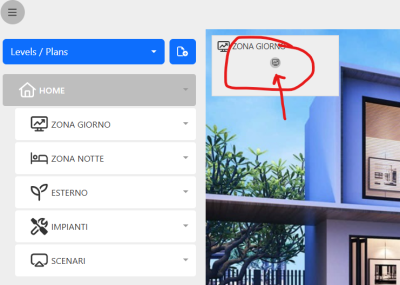

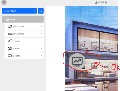

RE: Cristian First test - CristianAgata - 08.02.2025
Hi Team,
I've found a strange behavior in the plan link, the icon of the link in plan view are ok in tile view is not ok (I've tested with several format WxH but all have problem).
I attached the image.
Best regards Cristian

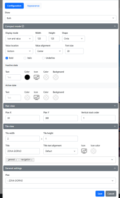

RE: Cristian First test - admin - 10.02.2025
Set "display mode" to "icon" or provide text for both states (active/inactive).
RE: Cristian First test - CristianAgata - 10.02.2025
(10.02.2025, 07:13)admin Wrote: Set "display mode" to "icon" or provide text for both states (active/inactive).
