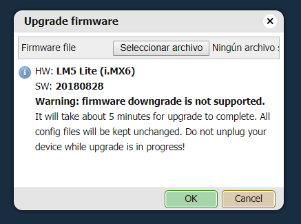

I've just upgrade the firmware. Here's the actual version:
[Image: firmware.png]
Here's my code where I put the mosquitto test broker and the topic "arqueta/humedad" I'm testing. the object 32/1/1 is a "05. 1 byte unsigned integer".
