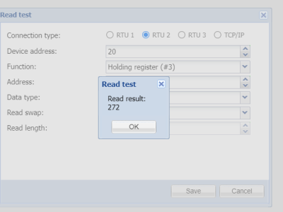

Posts: 8722
498
Can you read this register value using read test? When using bitmask for a single bit in a register you can set bus_datatype to "bool".

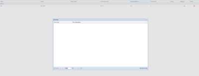

Posts: 8722
498
Do you have any errors in the Modbus error log?
