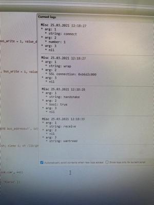

The log for gmail is:
"Event for Mail (32/1/39) 27.11.2020 22:54:47
* arg: 1
* string: connect
* arg: 2
* nil
* arg: 3
* string: timeout"
The log for local account;
"Event for Mail (32/1/39) 27.11.2020 23:01:10
* arg: 1
* string: connect
* arg: 2
* number: 1
* arg: 3
* nil
* arg: 1
* string: wrap
* arg: 2
* SSL connection: 0xb6f0eda8
* arg: 3
* nil
* arg: 1
* string: handshake
* arg: 2
* bool: true
* arg: 3
* nil
Event for Mail (32/1/39) 27.11.2020 23:01:15
* arg: 1
* string: receive
* arg: 2
* nil
* arg: 3
* string: wantread
