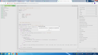

First of all let me thank you for your support.
Unfortunately this script does not work as well. Log is this one:
Pompa_circolazione_mansarda 24.10.2018 22:22:13
* nil
[size=undefined]
Pompa_circolazione_mansarda 24.10.2018 22:23:23
* nil
[/size]
I am getting crazy. It is very strange because I use the same code for in other 2 scripts and they are working without any problem. System is working with these scripts for about 1 year without any problem. Since 16th of September script related to circulation pump with address 2/0/2 does not work anymore.
The function is very easy. I have this following variable:
- heating and cooling valve state
- dehumidifier valve state.
In winter when heating valve state (2/0/107) is ON, circulation pump must start after 60 seconds or the time I fix. When heating state valve is OFF, circulation pump must stop immediately.
In summer when cooling valve state (2/0/107) or dehumidifier valve state are ON, circulation pump must start after 60 seconds or the time I fix. When cooling valve state or dehumidifier valve state are OFF, circulation pump must stop immediately.
I cannot understand the reason why it does not anymore.
#51
What did you logged?
Done is better than perfect
#52
(24.10.2018, 20:51)buuuudzik Wrote: What did you logged?
Nothing, I simply copy your code and I verify if there was some log in that script. I saw it but if now I check again there is not anything.
Probably it was simply a misprint of previous code.
In any case it does not work.
It could be how I wrote the tag descrption? pompa_circolazione_mansarda_inverno probably too long? too _ underscore?
#53
If I can give you some tips:
- tags shouldn't be very, very long because if they are very long you can accidently assign new tag which is misspelled and probably you don't see whole tag/tags in Objects view. In your case you has e.g. "pompa_circolazione_giorno_estate" which means "circulation pump summer day" so you can think how to short this name, maybe you can remove "day" from it, use shortcut name and let e.g. pump_ce1
- please use english in your code, you will do better programs, all people in forums can help
 you faster.
- when you debug code don't be afraid to use a lot of log() function (also like log('Label 1', your_variable)) and also try to check step by step where is the start of the problem because when you have complex script then when something is bad calculated at start then end could be very mess and unpredictable so you should check full path from. You can also log only certain data e.g. when you are logging knx object then you can log full object but more readable would be to log only specific properties like log(obj.name, obj.value).
- use functions for splitting your code into a few simple and easy to test parts which would be also much more readable
- use tables, objects, for loops, tags for multiple zones, don't create another script for it
- for checking simple Lua based thing in code you can check also such tool like https://www.lua.org/demo.html
This are only some tips from me, because I see that you are trying to do better(more advanced) programs.
If it about your code please check step by step every line. I'm strongly recommend you use this last version because it is more readable and more ready for future changes which you will probably do.
1. Please stop all other pump circulation scripts.
2. Please use another script with a name e.g. 'Test' (it must be fresh script)and copy there such script which parallelly creates logs object and at the end ot prints it:
-- DEFINE GLOBAL VARIABLES AND ZONES------------------
seasonGA = '2/0/100'
logging = true
zones = {
        summer = 'pompa_circolazione_giorno_estate',
        winter = 'pompa_circolazione_giorno_inverno',

Hi buuuudzik,
there is a mistake in the code. Enclosed the error.
