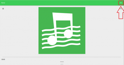

Have someone tried to change sonos exit link from /apps to scada-vis  (javascript)
Tnx
Normally not possible, custom JS is not available for the apps section.
Only thing that is possible is to use a app in a iframe under the normal visu and use custom JS to find the iframe and perform JS action on the content in the iframe.
Another option is to find the source code on the apps ftp folder and manipulate the source, downside is when you update the app your manual changes are overwritten again.
