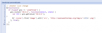

as in the subject, I would use a script to pass a string as URL for a frame or image graphic element.

I just would like to change the URL on an event, passing it in a string by a script.

I am trying to pass the url to an image obect... where am I wrong there?
Posts: 8627
490
Replace image selector with img

Perfect!
Thank you so much.
