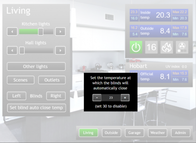

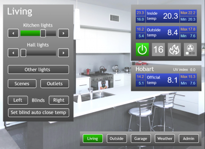

Posts: 21
Threads: 3
Joined: Aug 2019
09.10.2019, 13:41
(This post was last modified: 09.10.2019, 13:45 by tassiebean .)
Hi Erwin,
Thanks for your prompt response, as always! I didn't manage to get your fading background JS to work. Have you tried it? Also, what does the 500 refer to?
Just so I explain myself properly, I have two images below - one without the widget, and one with the widget. You can see that when the widget is displayed, everything in the background fades.
I will try the auto-closing widgets thread tomorrow.
Posts: 1793
Threads: 6
120
11.10.2019, 19:46
(This post was last modified: 11.10.2019, 20:09 by Erwin van der Zwart .)
Sorry, i tested with only 1 widget and then it works, but when having more then 1 widget i does not work (:
Here is a updated version for multiple widgets:
