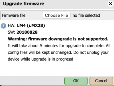

I am unable to perform the firmware upgrade, not sure what is wrong with my LM4 running i.MX28 CPU, looks that the logs are indicating some filesystem errors:

I have also enclosed some images with what I see after trying to upgrade the firmware on my LM4. Basically, the FW version has remained the same as before doing the upgrade.
#42
Does anyone knows why my LM4 does not accepts the new firmware and stays stuck on the older firmware?
#43
(23.09.2020, 16:53)andeug Wrote: Does anyone knows why my LM4 does not accepts the new firmware and stays stuck on the older firmware?
Your card is in read only mode and needs replacement

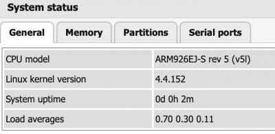

I have an old LM2, labeled LM2 interface 2. The displayed firmware version is 20141127.
I tried to download the new LM2 firware from the top of this thread, but when i try to install with the function "Systemconfiguration, System, Upgrade firmware", the upgrade prosess seems to start, but the version remains the same after rebooting.
When trying to use the function "Utilities, Install updates", i got the message "Update package file is invalid".
I have also made a factory reset.
In case my LM2 unit is not supported anymore, is there any newer firmvare available?

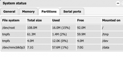

Send a screenshot from System config->Status->System status -> Partitions
#56
(27.10.2020, 11:16)Daniel. Wrote: Send a screenshot from System config->Status->System status -> Partitions
#57
This is LM version is not supported anymore. The latest firmware for it is 20181002: https://dl.openrb.com/lm-18-at91/20181002.img
