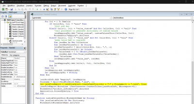

Hi, I get an error when I try to generate the profle.
I use MS Office 385 on two different PC anche strange thing is it work perfectly on one and even in the other PC I get errors.
Can you see what happens?
Thank in advance
Peppe

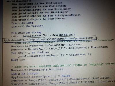

mmm.. no. Because the macro goes on until it stops on a certain line, as you can see in the picture...
I 'll investigate, I will let you know  Smile
I think it has something to do with the xlsm file path. Try putting it into a different folder.
(17.11.2021, 14:52)admin Wrote: I think it has something to do with the xlsm file path. Try putting it into a different folder.
Already done. Tried in diffent folders, ieven in desktop...
I found the cause of the problem... but not the solution! Smile
cdir = Application.ActiveWorkbook.Path
But Application.ActiveWorkbook.Path is not the path you can see on the picture ("https:\\ ... ect.")
The actual path is "C:\user\Peppe\Desktop"
I checked it on the PC in which it works and I found the right path.
That's very strange because it is the same file in the same position (Desktop) on two different PCs.
I also reinstalled Office but nothing changed.
