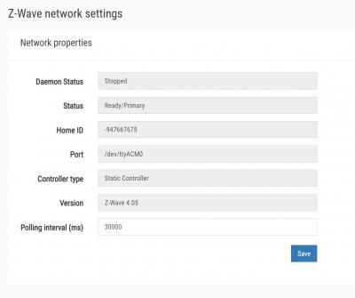

Hi! Update my reactor v3, but now i cannot start the Z-wave daemon. Have tried restarting several times, tried unplugging the usb and plug it back (coming blue light) but cant start daemon.
#19
Have you updated the app to the latest version?
#20
(23.06.2021, 08:26)admin Wrote: Have you updated the app to the latest version?
Checked now, here is the message..... Sad
