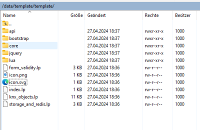

If I store the data via ftp in /data, do I have to pay attention to anything else? Because the app is then not displayed. Or do I have to make an .ipk out of it?
#32
Do you have index.lp and icon.png or icon.svg in your app directory?
#33
Yes i have
#34
Path should be /data/template not /data/template/template
#35
