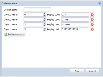

Add Custom values to control object and set Control type to "Custom value select" in Vis. parameters
(17.04.2018, 10:04)admin Wrote: Add Custom values to control object and set Control type to "Custom value select" in Vis. parameters
Sorry, I don't understand
Can you give me an example?
Thank you so much!
