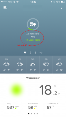

How to get the outdoor air quality value with the API?
See attached image for the requested value.
(11.01.2016, 14:59)gjniewenhuijse Wrote: How to get the outdoor air quality value with the API?
I am not sure you can do that, it's not something netatmo calcule, it's value from a third party.
