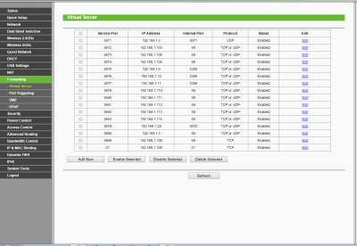

hi
try in protocol to have only UDP
check if the 80 port is open
check if 80 is free mayde use that the router for remote

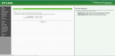

(28.08.2018, 19:06)Erwin van der Zwart Wrote: Hi,
Can you check under NAT if the service is enabled (both current NAT and current hardware NAT status)
  • Enable NAT Control - If enabled, the NAT function and the Forwarding configuration will take effect.
  • Disable NAT Control - If disabled,neither NAT function nor Forwarding configuration will take effect.
BR,
Erwin
Hi Erwin
the problem remains
Also, all the other ports work well.
I have more 14 ports and all are ok.

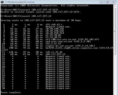

(29.08.2018, 20:10)Erwin van der Zwart Wrote:
(29.08.2018, 12:53)XSPA2474KW Wrote: Thanks Edgars,
but I had port 3671 to forward to HomeLynk visualization. And it worked fine. Now I use again external port 3671 to 80 for Visulation. do you mean that probably my Router blocks internal port?
BR
Why do you forward 3671 to 80?? This is wrong! 80 is for webbased visu (html) and 3671 is for KNX IP protocol. Please read some articles about this..
BR,
Erwin
Dear Edgar,
I think that is a mistake from my side. I forward 3668 to 80 for visualization and 3671 to 3671 for KNX protocol. My main question was that I have tried from 2 different ISP's from 2 friends houses and I had the same problem. All IPS's have a problem? I think it is too strange.
Also, I have tracerouted and I send the picture. Sorry, but I can't understand too much. Any of these 30 hops cause the problem? And how can find which?
Thanks in advance for your time.
BR
