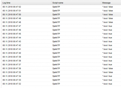

Try this
function check()
local delta, wdt
wdt = io.readfile('/tmp/tpuart.wdt') or ''
wdt = tonumber(wdt) or 0
delta = os.time() - wdt
return delta <= 10
checktp = check()
log(checktp)

(08.11.2018, 08:28)Trond Hoyem Wrote: (08.11.2018, 08:03)admin Wrote: It might be a hardware issue. Which LM model are you using? Also measure bus voltage if possible.
It is a SpaceLYnk of the HW 1. If I am not mistaken, the FW is 2.1.0
There was a bug in this FW, install any new and problem will be solved.
