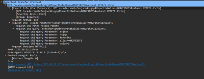

Dear admin,
From Zennio packet capture I gout this when opening it in Wireshark: GET /scada-remote?m=json&r=grp&fn=write&alias=40%2F1%2F1&value=1 HTTP/1.1
is there any thing in this command?
while the command didn't executed by SL
Best Regards,
Posts: 8209
Threads: 43
473
Provide full capture of the HTTP request. It should include headers like Host, etc.
Posts: 8209
Threads: 43
473
Double click the request line in the table. A window will open where headers will be under "Hypertext Transfer Protocol".
Posts: 8209
Threads: 43
473
It does not work because the Authorization header is not sent with the request. Certain integrations expect a WWW-Authenticate to be sent by the server before sending the Authorization header.
Next firmware will have an option in Remote services settings to enable old behavior with the "WWW-Authenticate" header.
