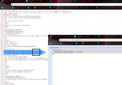

I am sorry, it was hard when I first approached the Java script. Do you think I wrote this correctly? I do not see it translated into my language.
You can write for me, translate "Name", "Run-at", "Value" into words "Tên", "Thời gian", "Giá trị". Let me have a more overview.

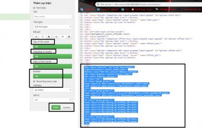

I have some words that can't be translated, I don't know how! It is in my round section. Can anybody help me? I really thank you all!

Thanks Admin!You are so pro!, I did it! Can you show me how you can pull the whole word to translate for me so quickly?
On the interface page, on google chorme, I pressed F12, and I came out here. Do you have to filter out from here?

These are from view source mode (CTRL+u). You can use a text editor that supports search by regular expression (%.+%) to match all translation phrases.

add attachment as jpeg
Posts: 41
Threads: 9
Joined: Jan 2016
Here is an screenshot

These labels are missing, add them to your Custom JS and translate:
Translations.schedulers_holidays_new = "New holiday";
Translations.schedulers_events_month_dow_1 = "1st";
Translations.schedulers_events_month_dow_2 = "2nd";
Translations.schedulers_events_month_dow_3 = "3rd";
Translations.schedulers_events_month_dow_4 = "4th";
Translations.schedulers_events_month_dow_5 = "5th";
Translations.schedulers_events_month_dow_6 = "Last";
Translations.schedulers_duration_days = "d.";
Translations.schedulers_events_time = "Specific time";
Translations.schedulers_events_sunrise = "Sunrise";
Translations.schedulers_events_sunset = "Sunset";
Translations.schedulers_events_before_sunset = "before sunset";
Translations.schedulers_events_before_sunrise = "before sunrise";
Translations.schedulers_events_after_sunset = "after sunset";
Translations.schedulers_events_after_sunrise = "after sunrise";
Translations.schedulers_events_offset = "Start time offset";
Translations.schedulers_holiday = "Holiday";
Translations.schedulers_all = "All";
Translations.schedulers_none = "None";
Translations.schedulers_load_error = "Error: scheduler load failed or access denied";

Hi everyone, I am currently unable to use this translation in higher LM versions. I am using LM version 20240219, is there any way to fix it?
Thanks everyone!
Translations.schedulers_name= 'Tên';
Translations.schedulers_run_at= 'Thời gian';
Translations.schedulers_value= 'Giá trị';
Translations.schedulers_status= 'Trạng thái';
Translations.schedulers_events_add= 'Thêm sự kiện';
Translations.edit= 'Sửa';
Translations.delete= 'Xóa';
Translations.save= 'Lưu';
Translations.cancel= 'Hủy';
Translations.schedulers_all = "Tất cả";
Translations.schedulers_none = "Bỏ chọn";
Translations.schedulers_period_alt= 'Chu kỳ';
Translations.schedulers_holidays_add= 'Thêm kỳ nghỉ';
Translations.schedulers_events_active= 'Kích hoạt';
Translations.schedulers_events_time= 'Đặt thời gian';
Translations.schedulers_events_sunrise= 'Bình minh';
Translations.schedulers_events_sunset= 'Hoàng hôn';
Translations.schedulers_events_before_sunset = "Trước hoàng hôn";
Translations.schedulers_events_before_sunrise = "Trước bình minh";
Translations.schedulers_events_after_sunset = "Sau hoàng hôn";
Translations.schedulers_events_after_sunrise = "Sau bình minh";
Translations.schedulers_time = 'Đặt giờ';
Translations.schedulers_events_offset= 'Cộng thêm';
Translations.schedulers_events_dow = 'Ngày trong tuần';
Translations.schedulers_events_month_dow= 'Tuần trong tháng';
Translations.schedulers_events_month_days='Ngày trong tháng';
Translations.schedulers_events_months='Tháng';
Translations.schedulers_edit = "Chỉnh lập lịch";
Translations.schedulers_status_active = "Kích hoạt";
Translations.schedulers_holidays = "Kỳ nghỉ";
Translations.schedulers_holidays_no = "Không chạy theo kỳ nghỉ";
Translations.schedulers_holidays_yes = "Chạy theo kỳ nghỉ";
Translations.schedulers_holidays_none = "Không";
Translations.schedulers_events_year = "Định kỳ mỗi năm";
Translations.schedulers_events_new = "Thêm sự kiện ở đây";
Translations.schedulers_events_edit = "Chỉnh sự kiện";
Translations.schedulers_events_delete_confirm = "Bạn có muốn xóa sự kiện này không?";
Translations.schedulers_start = "Bắt đầu";
Translations.schedulers_end = "Kết thúc";
Translations.dt_1_11_0 = "Không kích hoạt";
Translations.dt_1_11_1 = "Kích hoạt";
Translations.dt_1_1_0 = "Tắt";
Translations.dt_1_1_1 = "Bật";
Translations.schedulers_holidays_new = "Thêm kỳ nghỉ ở đây";
Translations.schedulers_holidays_delete_confirm = "Bạn có muốn xóa kỳ nghỉ này không?";
Translations.schedulers_holidays_edit = "Chỉnh kỳ nghỉ";
Translations.schedulers_holidays_recur = "Định kỳ mỗi năm";
Translations.schedulers_date_from = "Từ ngày";
Translations.schedulers_date_to = "Tới ngày";
Translations.schedulers_holidays_date = "Đặt thời gian";
Translations.schedulers_holidays_type = "Kỳ nghỉ";
Translations.schedulers_month = "Tháng";
Translations.schedulers_duration = "Liên tiếp(ngày)";
Translations.schedulers_events_weekdays = "Trong tuần";
Translations.schedulers_events_weekend = "Cuối tuần";
Translations.scripting_dt_month_1 = "Tháng 1";
Translations.scripting_dt_month_2 = "Tháng 2";
Translations.scripting_dt_month_3 = "Tháng 3";
Translations.scripting_dt_month_4 = "Tháng 4";
Translations.scripting_dt_month_5 = "Tháng 5";
Translations.scripting_dt_month_6 = "Tháng 6";
Translations.scripting_dt_month_7 = "Tháng 7";
Translations.scripting_dt_month_8 = "Tháng 8";
Translations.scripting_dt_month_9 = "Tháng 9";
Translations.scripting_dt_month_10 = "Tháng 10";
Translations.scripting_dt_month_11 = "Tháng 11";
Translations.scripting_dt_month_12 = "Tháng 12";
Translations.scripting_dt_month_apr = "Tháng 4";
Translations.scripting_dt_month_aug = "Tháng 8";
Translations.scripting_dt_month_dec = "Tháng 12";
Translations.scripting_dt_month_feb = "Tháng 2";
Translations.scripting_dt_month_jan = "Tháng 1";
Translations.scripting_dt_month_jul = "Tháng 7";
Translations.scripting_dt_month_jun = "Tháng 6";
Translations.scripting_dt_month_mar = "Tháng 3";
Translations.scripting_dt_month_may = "Tháng 5";
Translations.scripting_dt_month_nov = "Tháng 11";
Translations.scripting_dt_month_oct = "Tháng 10";
Translations.scripting_dt_month_sep = "Tháng 9";
Translations.scripting_dt_weekday_1 = "Thứ 2";
Translations.scripting_dt_weekday_2 = "Thứ 3";
Translations.scripting_dt_weekday_3 = "Thứ 4";
Translations.scripting_dt_weekday_4 = "Thứ 5";
Translations.scripting_dt_weekday_5 = "Thứ 6";
Translations.scripting_dt_weekday_6 = "Thứ 7";
Translations.scripting_dt_weekday_7 = "Chủ nhật";
Translations.scripting_dt_weekday_fri = "Thứ 6";
Translations.scripting_dt_weekday_mon = "Thứ 2";
Translations.scripting_dt_weekday_sat = "Thứ 7";
Translations.scripting_dt_weekday_sun = "Chủ nhật";
Translations.scripting_dt_weekday_thu = "Thứ 5";
Translations.scripting_dt_weekday_tue = "Thứ 3";
Translations.scripting_dt_weekday_wed = "Thứ 4";
Translations.schedulers_events_month_dow_1 = "Tuần 1";
Translations.schedulers_events_month_dow_2 = "Tuần 2";
Translations.schedulers_events_month_dow_3 = "Tuần 3";
Translations.schedulers_events_month_dow_4 = "Tuần 4";
Translations.schedulers_events_month_dow_5 = "Tuần 5";
Translations.schedulers_events_month_dow_6 = "Tuần 6";
$.fn.datepicker.dates = {
"days": [
"Chủ nhật",
"Thứ 2",
"Thứ 3",
"Thứ 4",
"Thứ 5",
"Thứ 6",
"Thứ 7",
"Chủ nhật"
"daysMin": [
"Su",
"Thứ hai",
"Thứ ba",
"Thứ tư",
"Thứ năm",
"Thứ sáu",
"Thứ bảy",
"Chủ nhật",
"Ngày lễ"
"months": [
"Tháng 1",
"Tháng 2",
"Tháng 3",
"Tháng 4",
"Tháng 5",
"Tháng 6",
"Tháng 7",
"Tháng 8",
"Tháng 9",
"Tháng 10",
"Tháng 11",
"Tháng 12"
"monthsShort": [
"T.1",
"T.2",
"T.3",
"T.4",
"T.5",
"T.6",
"T.7",
"T.8",
"T.9",
"T.10",
"T.11",
"T.12"
