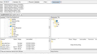

"I am not able to find this file...
I log in with FileZilla with both "apps" and "ftp", but cannot find this folder. I have neihter the folder /home/ftp" . I changed
if #buffer > 1 then
result, err = io.writefile ('/home/ftp/'..logfile, table.concat(buffer, '\r\n'))
log('Created log file '..logfile)
Can anyone see where that file is saved? Sad I can't see where that file is

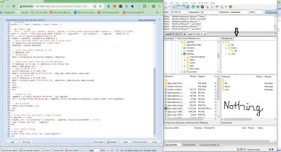

Help me !!  Can you explain more clearly how to do it, where to put this script, how to get the saved file? Because I don't see it Sad
Use ftp login and check base (top level) directory, the one that is marked as /

I still don't see anything.
I still don't see anything. I use version 20230612

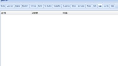

What logs and alerts says after running the script?
#18
hi Daniel !
I don't see anything in Alerts and Logs. Prove that the script runs well

Script from post #2 won't create a file if there are no logs in the given period.
#20
(18.06.2024, 08:36)admin Wrote: Script from post #2 won't create a file if there are no logs in the given period.
what do you mean? I don't quite understand, do you mean this script? Sad
