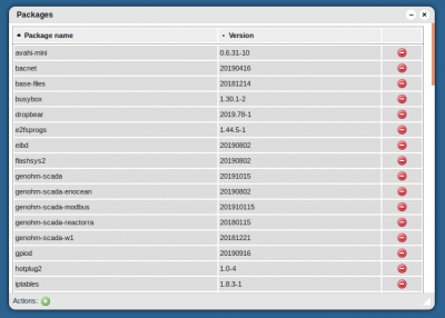

I've upgraded recenly LM5 RIO 2. Which packages should I also upgrade to have it fully upgraded? After upgrade e.g. Modbus could not work properly (it is not used on this installation but I want fully upgrade this device)?
Done is better than perfect
#10
This is very urgent!!!
After upgrade client told me that buttons connected to LM RIO2 are not working now. How can I solve this issue?
Its LM using only KNX and buttons, no modbus, no other interface.
You have so much versions, every piece is important(I/O, modbus, 1wire etc.) so I think upgrade should be done by LM automatically (including packages). Or at least LM should list in standarized way packages which should be used.
I've attached photo of his LM to simplify recognizing it.
Im attaching also screenshot from packages view
#11
Since this is a pre-release test version we recommend using it only in your personal installations where you have immediate physical access to the device.
As for packages all firmwares have everything pre-installed depending on what the device has on-board. Extra packages are needed for additional functionality like SNMP or 1-wire via USB on devices without on-board chip etc.
Can you provide remote access to this device that is not working? Have you checked that outputs are working?
#12
