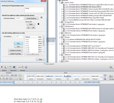

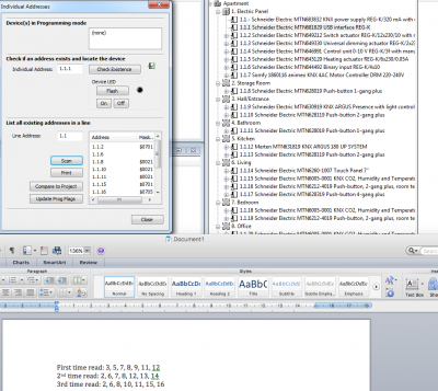

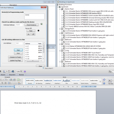

2. When I read the addresses on the line, they are randomly read via LM4's remote connection. I've repeated the scan 3 times and found that the results are different and not all the devices are discovered. Do I have a timeout somewhere? Has anyone experiencing the same issue?

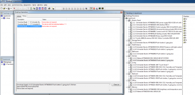

3. I am unable to program any of my KNX switches (and other KNX devices). Most of the devices are not responding anymore, although yesterday I was able to program them all by pressing the button in the back of the devices. This has happened at the first try.

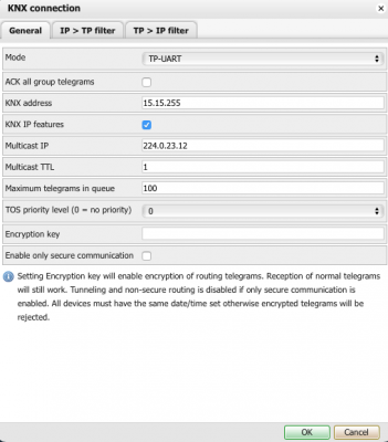

See attached what settings I have.
KNX Address: 15.15.255 - > This one I should change it?
Multicast IP: 224.0.23.12

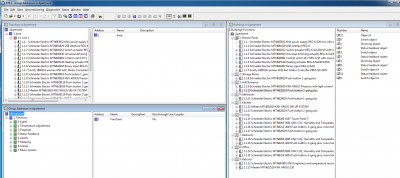

Also, all my devices are on a single bus line. I have attached a screenshot, for you to understand better how my project is structured. Is it okay that all addresses are starting with 1.1.xx? Please let me know if you need further information and hopefully I will be able to turn on again my lights today...
I'm in Sweden like in '89 in Eastern Europe, with only 6hrs of light/day, from outside... and I am unable to program my KNX bus.
Thank you,
Andreas

Just try setting the KNX address to 1.0.250, restart the LM. The see if you can program.
Thanks,
Roger
#37
Hi Roger,
I've set 1.1.0 to LM4 to the top of the line and all the devices are starting with 1.1.1.
Both USB and LM4 are programming now the devices locally or remote. This was my problem, actually.
Thanks a lot for your support and now all my programming via ETS3 works.
