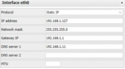

Thomas, did you set IP setting correctly on LM - subnet, gateway and valid DNS server? I had this issue for one of our partners when there was gateway missing in network settings.

(17.02.2017, 07:10)edgars Wrote: Thomas, did you set IP setting correctly on LM - subnet, gateway and valid DNS server? I had this issue for one of our partners when there was gateway missing in network settings.
I have the same problem, but IP settings are correct. What else could cause this problem?
Try 8.8.8.8 as DNS as i don't think current is correct..
(29.03.2017, 06:42)Erwin van der Zwart Wrote: Hi,
Didn't help

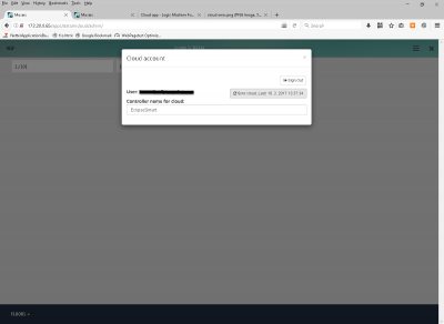

It has completely stopped work. I don't know why. The last replication was 16.2.2017.
Now "Sign Out" button does nothing.
"Sync cloud" ends in endless arrows rotating with no effect.
I tried uninstall and re-install the package.
IP settings is correct because I'm connected remotely and the weather forecast (Yahoo through LM API) and other services based on http access works. NTP works. The only thing which doesn't work is Cloud application.

there is temporary issue due to moving to other cloud server. In one hour all should work fine. Sorry for troubles.
