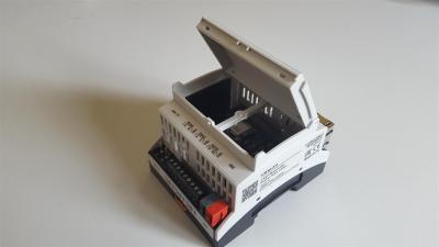

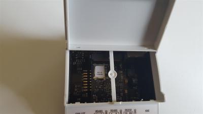

Logic Machine 5 series has option to open top cover so you don't have to disassembly the whole device but you should not need to Smile
