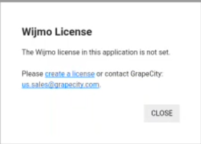

At this point I am sorry, but I am having another problem Rolleyes .
I have installed (sideloading through adb) the Logic Machine app on an Android tablet, and when I open the energy manager app it asks for some kind of license. I will attach a photo of the error. Sorry for the bad quality but I am remotely controlling the Android tablet and that is the best I can afford.
Might not be your problem but I will  ask anyway
#25
What Android version does it has?
#26
(24.05.2024, 09:48)Daniel Wrote: What Android version does it has?
It is not the latest  Smile . It's android 8.1
#27
It might be something to do with this as we can't see this. Is the time and date settings set correctly on the tablet?
#28
(24.05.2024, 10:08)Daniel Wrote: It might be something to do with this as we can't see this.  Is the time and date settings set correctly on the tablet?
Yes they are, with the right timezone, time and date
#29
Do you see the same if you open Mosaic?
#30
have been having some issue with mosaic, it never stops loading, so it might be the same problem
#31
This is websocket not establishing connection. Check if you can update Webview to the latest version.

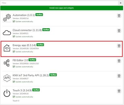

I have an error that seems to prevent me from interacting with the app, what so ever.
For me it seems like there is some conflicts between the energy app from schneider and this app.
I have uninstalled the schneider energy app, but when installing this apps .ipk manually, it is
registered as the official schneider enery app :S
Best regards
Christian
#35
Smile SE has its own app, with same name I think. We never tested this on SE hardware knowing they have other solution.
Technically it should work but due to same name it may have some conflict as it tries to install on same location.
