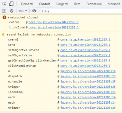

after upgrading a LM5 lite the commands in the scada-vis doesn't work anymore... websocket error:

i tried a full reinstall via SD card recovery image and it doesn't work... after restoring the backup the scada-vis doesn't work, websocket error...

@cekca, thanks for providing access. This issue is caused by disabling password access to the visualization (not recommended for security reasons). It is fixed on your LM.
#36
(28.12.2022, 12:08)admin Wrote: @cekca, thanks for providing access. This issue is caused by disabling password access to the visualization (not recommended for security reasons). It is fixed on your LM.
thank you admin, the password is disabled because the LM visualisation is accessible in the local network and trough zerotier for remote access
no port forwarding to the device ( http 80 or udp 3671 ), i think there aren't security issue in this case
There will be an update to fix this issue?
